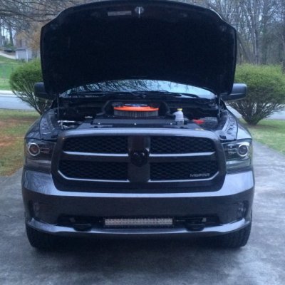

Yeah the vararam could use more refinement, I did a little trimming on the right side of the flap were the ac lines go into the ac condenser core to make mine sit straight. image.jpg
