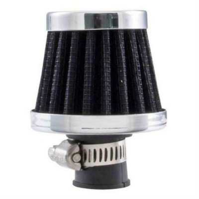

You can also straighten up the breather with one of these and a short piece of heater hose. Adjust the length of the hose so you can still access the fill cap. The second filter shown screws on in place of the filler cap, but is more expensive. I used the first style with a vararam on the 2012, the more expensive style I used when I had my Scat Pack.s-l500.jpg s-l1600.jpg

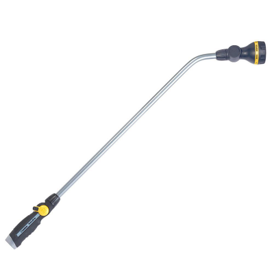

Forgot to add to my post above: If you use this filter, a short piece of tubing works great between the filter nipple and a short piece of 3/4" hose. I used 3/4" heater hose on the intake and then a short piece of one of these garden wands, then the filter on top. If you keep the bottom hose as short as possible it'll stand up-right. Everything goes together tightly, plus the wand is 3/4" aluminum and available in various anodized colors. (mine was a purple one I had lying around). You can cut the tubing to your desired height. If needed you can use a zip-tie around the tubing and filler to help keep it in place. s-l500.jpg s-l1600.png
