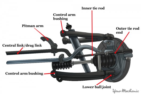

Check all these parts, especially rubber parts.
https://www.yourmechanic.com/article/how-to-diagnose-a-shaking-steering-wheel-by-timothy-charlet
