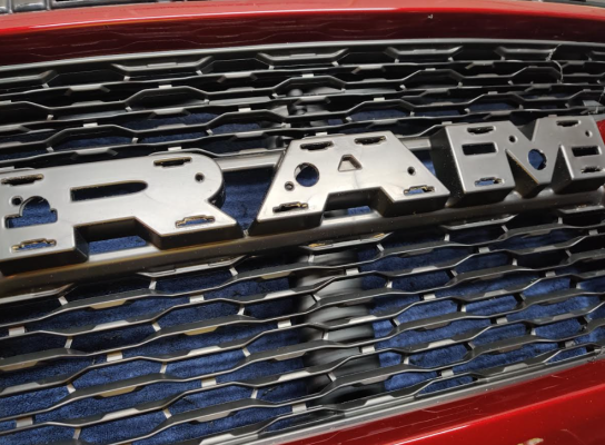

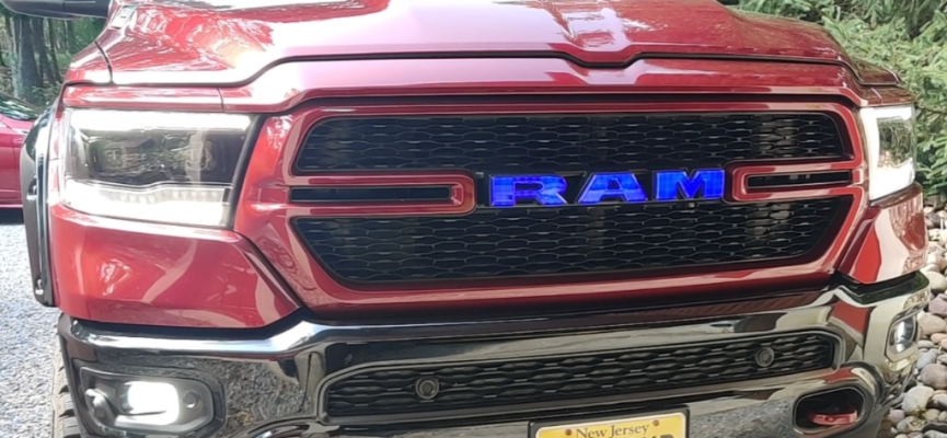

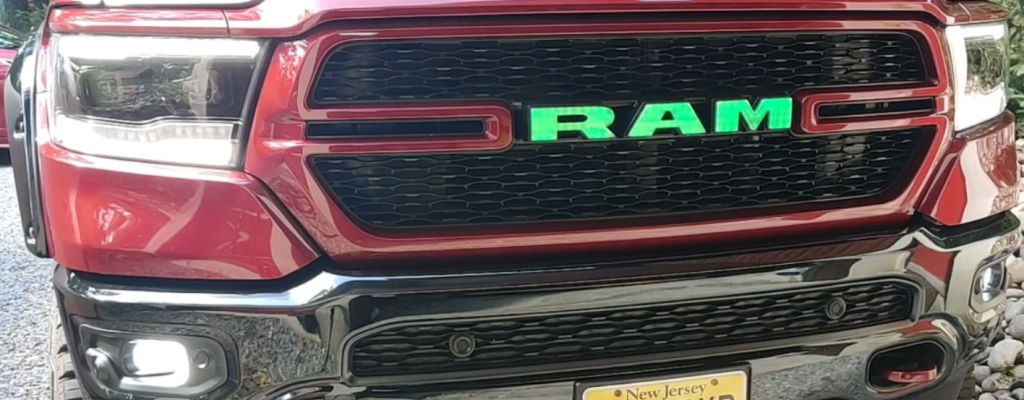

One year later, I still love the LED grille emblem! They work perfectly and still look just like the day I installed them. I decided not to run them all them time and now I use the wireless remote from inside the truck to toggle them on and change colors, though the blue tones seem to be my favorite. Pulling the grille off is no fun, but I was installing new headlights that day too, so I was already taking it off. After removing the OEM RAM letters I had to drill three holes with a step bit to get the wiring/connectors through to the back side, see pic below. Was super easy and the holes are behind the letters and will never be seen. It might be possible to install w/o removing the grill....but having the grill off made it easier. Let me know if you do it!

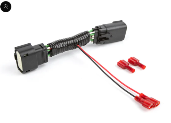

They look amazing! Great job. So I'm assuming because you're using the remote, that you just went straight to the battery? I was thinking of getting a $50 parking light harness. Do you have to use the remote or can you have them power on with the lights

I bought the harness and it said it would only handle 2 amps (I think). The emblem must draw more than that and immediately caused havoc with my new headlights. I could have wired the harness to a relay as a trigger and I'm sure it would have worked. But I just ended up wiring to the battery and using the remote. Works fine!
