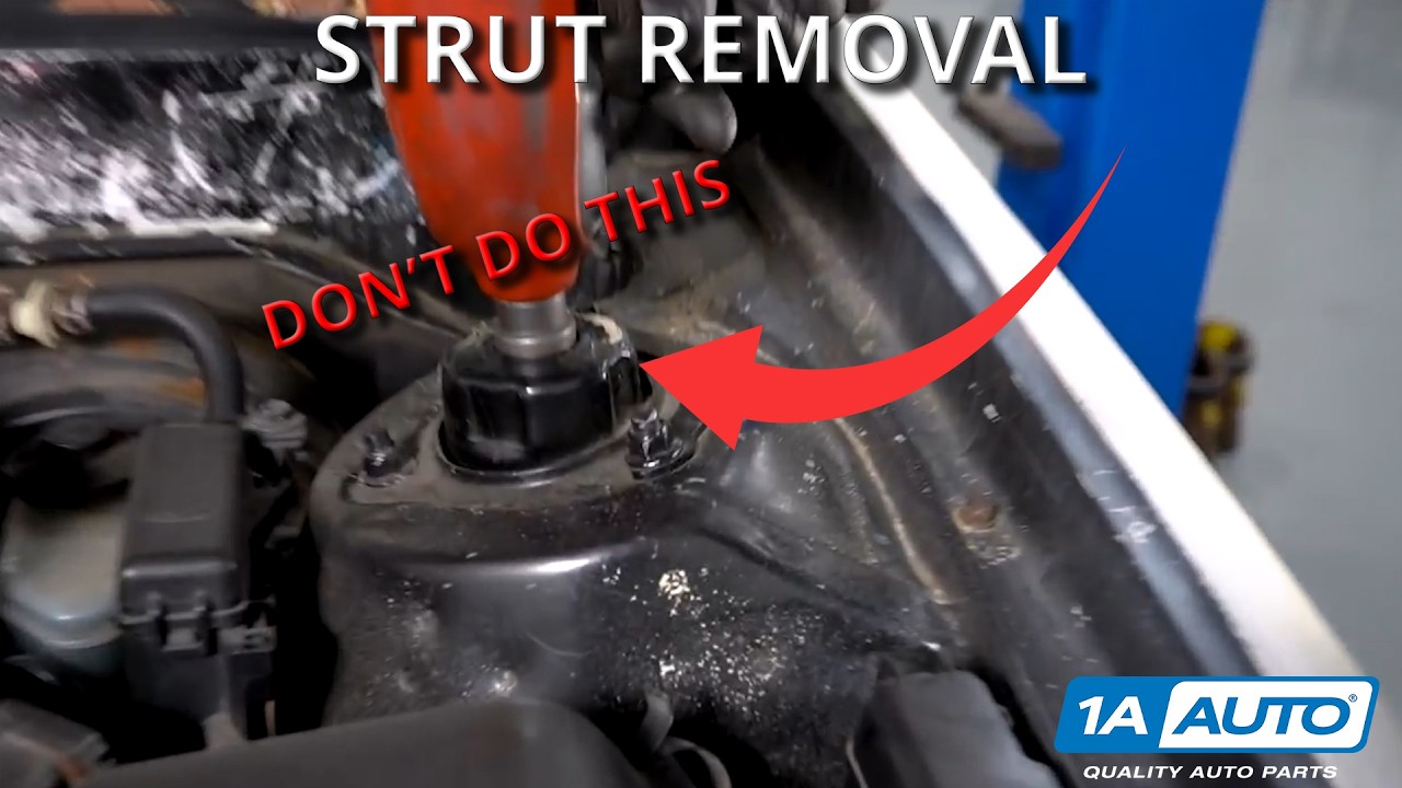

not knowing where you are as a mechanic, i suggest you watch this video, its made a little bit in jest, but it covers just about everything that one could do wrong
at about the 5 minute mark he addresses your question "should i get a loaded shock or a bare one?"
