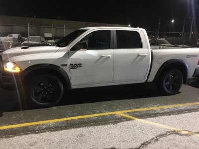

Hey I have a 19 warlock, looking to get an aggressive beefier all terrain tire, anyone have anyone who has any insight on what size I can potentially fit without rub?

275 60 r 20

Ive heard of people fitting 33’s stock on 20x12 rims. Thats what ill be doing once i get some extra $

Want more rubber so wanted to downsize rim, thanks man!

What size rim are you looking to go with.

If you go with a 17x8" wheel with a 25.4mm positive offset (as in, stock 3rd gen Ram wheels) you can do a 285/70R17 which is 32.7"x11.2" - or you can do 255/80R17 which is 33.1"x10" . I have had both sizes on my Tradesman 1500
You can't go any wider on that wheel offset due to the upper control arm, it's tight there. But if you get a neutral offset wheel I believe you can run 33x12.5R17

275/65/R20 which is a 34 will fit easily. Could almost do a 35x11.50 but there might be trimming involved with going that large with no level and not sure if you would need wheel spacers or not.

Keep in mind the warlocks come with a factory 1” lift. I pick mine up next Saturday. I am putting on 17x9 with a -12 offset and 35x12.5x17 tires. I also am going to add bilstein in the front.
