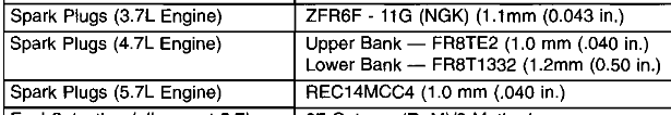

I found the 10,000 page book for it. Wow.
This is what I found for the 4.7 in the book.
There is another entry under EXPORT, pictured below
tho it doesn't list upper/lower banks which is what mine has.
another entry about the spark plugs for the 4.7
