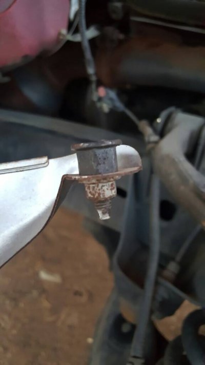

Found this today,
So looks like I'll be not driving the R/T for a bit while i do the To/do list.

Drives me nuts, cant stand that exhaust leak sound. I have a long list of other stuff to do so i figured screw it... I just don't want to spend 2k right now on headers then another 500+ to rework the whole exhuast.. I have the parts for the exhaust though except I will need more V-band clamps, and the ones I got weren't too cheap. I'll probably break down and buy some kooks. just depend on if I have the time with all the other stuff to do

Could bee worse , broke off flush at the head
Looks simple to me to fix

for those of us mechanically challenged what are we looking at and oh with 8000 miles on my 15 I consider her a high miler lol
Yeah, I'm thinking it will be somewhat easy from the looks.... then there is that ********** murphy and his damn laws so it will prob be a *****....
Top left of the exhaust manifold you will see what looks like a nub in a hole in the first picture. That is where the bolt snapped in two at some point in its life... second picture shows the nut head and rest of the stud still attached to the heat shield.

You would think by now that they would redesign the headers so this crap would quit happening. The problem with this design is that all 4 cylinders dump into the same tube and all that heat collects at the back of the manifold where those bolts are which causes them break. Just about every hemi that has a broken manifold bolt is in that same spot. I have had a 2006,09,10,13,and 2 2014's and all have had the same bolt break in the exact same spot. If not on that same side then they have been broken on both sides. on the 2006 I replaced them twice before I put on BBK ceramic shorty headers and never had another issue with them...... terrible design flaw :flipthebird:

Well they all came out scary easy. Got home at 6, had hr manifold off and catch can, and throttle body cleaned by 7....

Good. Mine was flush with the head but was still pretty easy.
