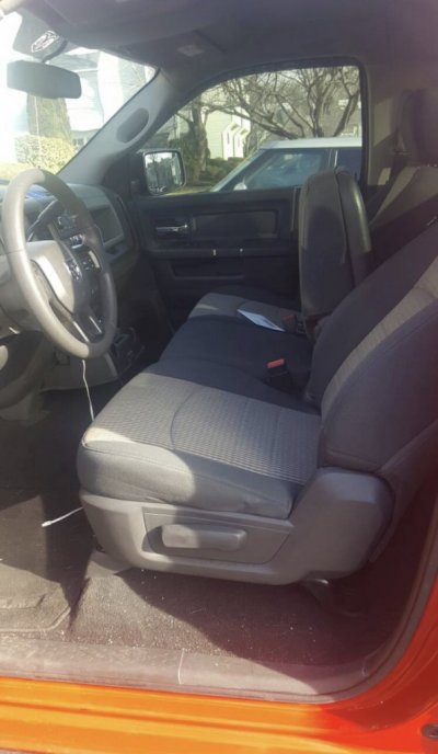

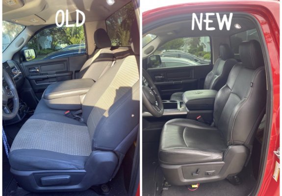

Here is my old 2012 stock cloth seats... looks so old and outdated and basic.
And here were the new seats from a 2015 Sport.
Also did a center console swap, i hated the jump seat setup.
