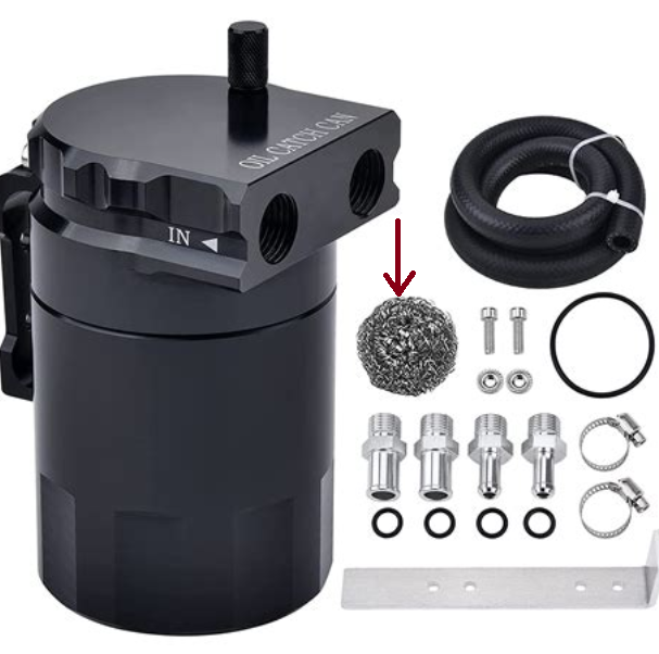

Many catch cans come with what looks like a pot scrubber that is often behind a piece of perforated metal inside the can. In this pic I grabbed from the web I've added a red arrow pointing to the filter (condenser is a more accurate term for it)...
