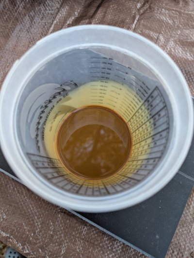

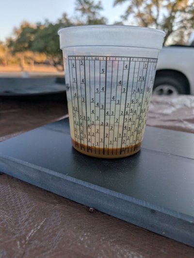

Just got home from a 1600 mile round trip in adverse northern type conditions. 20-30 degrees snow sleet etc. Pulled catch can and found 3 ounces of milkshake. Running HPL SC 0W30 2000 miles on current oil change. It's easier to dump than making a cup of coffee.
Kickboxer
Feb 18, 2020
402
507
ND
5.7 Hemi-non-Etorque
The milkshake is 90% water, I suppose you should know that........
Yup - I believe I read Mazda was the only company that attempted to put a oil vapor coalescer (what you all call "catch cans") on their PCV system. I have seen it in engine schematics, so I presume it is real.
Further, it does things correctly in that you don't have to manually drain the damned thing - it has a drain hose from the coalesced vapor (I know it is a mix of water and oil, so don't tell me) back to the oil sump.
That's how we did things on the big diesel engines too.
And that shouldn’t hurt a thing, for the next time the engine warms-up …any water will cook-out. It’s normal operations.
