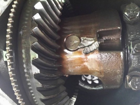

Now I know why it locked up, the pinion smacked into the carrier when the nut let go.
And found a couple pieces of the ends of the teeth that hit.

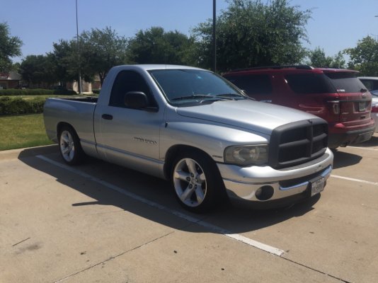

New wheels and tires along with the drop.
Next step is the bumper and grill.
Going to paint match both.

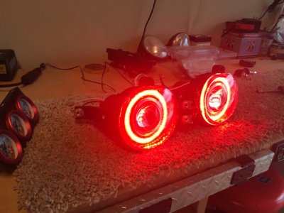

Got my rebuilt fog lights installed, slightly different colour so I might change the upper rings to match.cce02c4c00b8623bdff6452be07d2686.jpg4333b816ab6a73ef866e974fb72a68ad.jpg

what did you use on your fogs, I see some red in there on the halo?
I made a set of headlights and took a set of those fogs and put in matching Red Halos

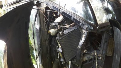

Finally got my condenser fan replaced.it's only been upper 90s for a couple months now.uploadfromtaptalk1470154325663.jpg

Finally got my condenser fan replaced.it's only been upper 90s for a couple months now.View attachment 75319
2003 1500 QuadCab 5.7 4x4
Nice, I gotta do mine, but it also smoked the compressor so not in a hurry. Hope you got it cheap on rock auto.

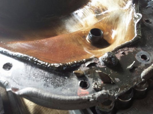

So, I changed my oil today and there was less than 3 qts that came out! Manual says 7qt capacity. WTF?!
