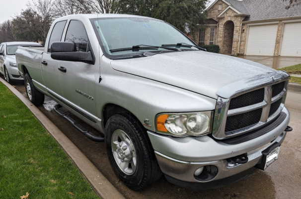

Decided that her time had come (time to strip the add-ons) and bought a 4th gen.
