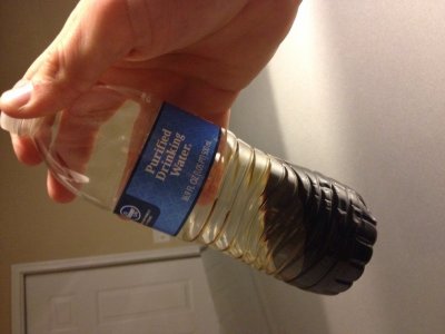

I am a fairly new member and Ram owner, I have seen several posts where you guys mention a Catch Can. Could someone help me understand what it is and what it does?
Thanks.
It keeps the PVC oil out of the intake. Get one!

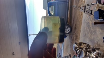

Yeah I'm a believer. My ram is around 7k miles. Had a can on it from about the first month. Hasn't gone in for its first oil change yet, but that can has caught at least a cup worth of oil so far. (For the measurement challenged that's about a 1/4 of a quart!)
