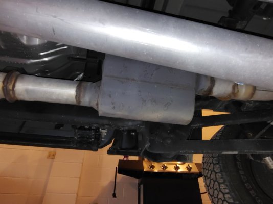

We dont have any customers running that have tried to add a resonator to help with drone. Is there any branding on the muffler you have now?
We can help with a full catback or a different muffler kit. Post some pics of your setup and I'll do my best to help you find a solution.
I do not see any name brand on it.
Well theres the answer, that looks like a flowmaster or flowmaster knock off chambered muffler, better known as dronemaster. While a resonator may help I dont think it will solve it. I would swap that out with a different muffler. that would be my 1st move. Unfortunately they did not use a bolt in muffler kit, because you would then be able to unbolt that and bolt in a new muffler kit. You can still get a muffler kit but it will take a little fab work now to install it.
Our customers really like this option. With its straight through design it has a deep tone and can get aggressive when you want it to but is not obnoxious. It deals with drone very well, much better than a chambered muffler would.
Thanks for the suggestion but I am going to buy the borla kit. Hoping maybe I can find a memorial day sale on it.
