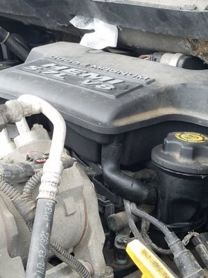

Howdy folks,
The hose pictured here running between the engine oil fill and the....intake resonator... is shot and I've been unable to find the name or part number. Been to my local O'Reilly's and Napa, and it is not shown on a web based Mopar parts site. Napa thinks it called "Engine oil separator vent hose" and they can't get one.
Ideas?
Thanks,

im going to go ahead and say that is your Positive crankcase ventilation hose (PCV hose).

its just a breather hose.any hose that fits will work fine.

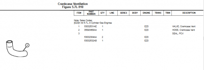

Crankcase vent hose, #2 on the diagram. You can use any similar sized hose though.
Part number 5093468AA, pretty sure it's discontinued but you might be able to find one.
