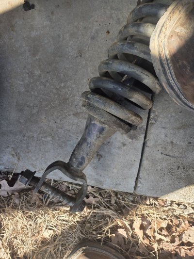

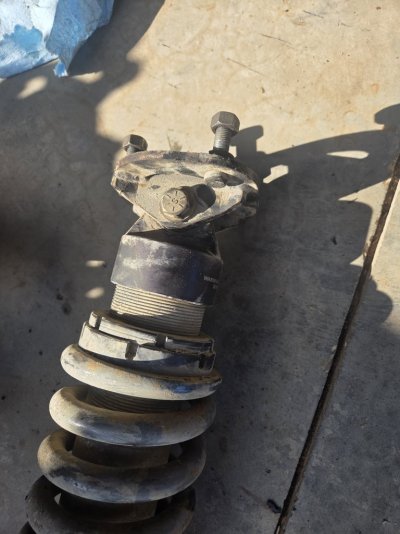

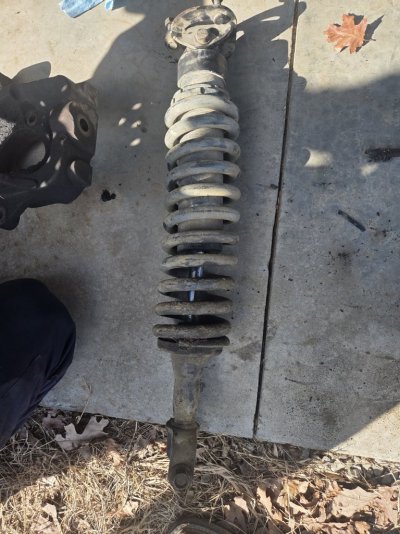

909.jpgrebuilding the front end of my wifes 2010 dodge ram 1500 4wd and noticed the driver side strut was bent. It has what i believe to be a 4" rough country lift on it. ( front cross member says ro engraved and measures 4" bolt center to bolt center). When i look on rough countrys website I can't find anything like this one at all. Even looked for other brands and can't seem to find the same kind. Any help or i sight greatly appreciated thanks!

I think the drop brackets only lower the arms/diff 4” even for a 6” kit. So it could be 6” also.
Are there any spacers over for the struts, or are they full length?

Gonna have to wash the puppies up good and look all over for some kinda stamp or just measure them and do your best to get as close as possible to 2 new ones....look like 6" lift struts to me...those mounts are whats confusing usually see those mounts if the strut has a bypass resovoir that is part of the strut connected via a hose
