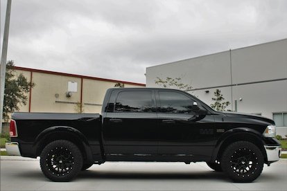

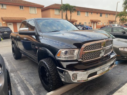

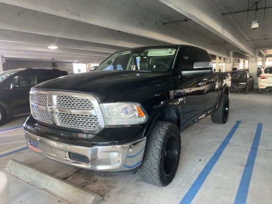

Good day gents, I am new to the forum and I wanted to ask for some guidance. I have a 2014 Ram 1500 2WD with the dreaded air suspension. Here is my dilemma, I want to remove the air suspension and add a 4 inch lift kit, I know the suspension is pretty much the same as the regular RAM with the exception of the front struts, in the front I would have to use the pre loaded struts from a 4WD since the front air struts use the same mounting system instead of the regular spring/shock setup. Here is my question, I am looking to install this lift but instead of using the shocks that come with the kit I would use the Rough Country loaded struts I will be purchasing factory rear springs and isolators. My issue is whether I should purchase the standard height loaded struts or the 4" loaded struts since it is a 4" lift. I was going to go with the 3" lift but I think that the off road 1 setting is a little higher than that, I have included pictures of my truck on Off-Road 1 for reference if anyone can give me an idea of what height it's sitting at or has insight on the strut issue I would greatly appreciate it.

1. Please provide pictures of your front air bags.
2. We have preferred vendors on this forum that offer member discounts for parts and lift kits
3. You will not need factory rear springs they will come with the lift kit
4. Don't waist your money on rough country
