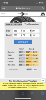

Good Afternoon,
I'm looking to purchase a set of take offs Size 285/60R20 for my 13 3500 but concerned the wheel size will be a concern. Stock size is a 275/70/R18. Any thoughts would be greatly appreciated.
Thank you
VelocityC6Z
Mar 26, 2020
310
318
Maryland
There's a lot to consider here really. What is the load rating on the old ones, and new ones as well. Weight of the old and new tires. Braking, mileage, ride quality... all things could be changed here going from 18's to 20's. Any details you have on the old ones and new ones, feel free to share.
In terms of "Will it fit? Will it affect my speedometer?" You're good to go, as the diameters are close enough that you won't notice a difference.
