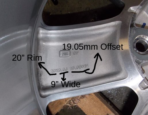

Here is a pic of the fitment specs for the OEM Sport polished 20x9" wheel....+19.05mm
I believe your black Sport wheels might be 20x8" so those specs might be off slightly. The stamp is probably on the same spot on the fins of the wheel so just have a look at yours,

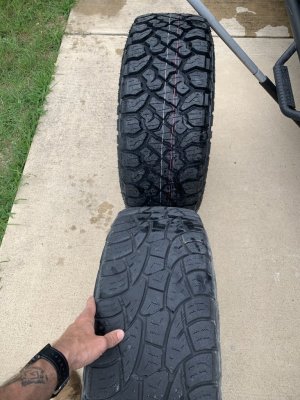

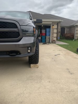

Depending on type of tire: AT, MT, Hybrid or street tire width would determine offset. I went from the OEM 20x9 +19 with a 275/65/20 Cooper ATP to a 17x9 -6 Pro Comp 32 with Kenda Klever R/T in 35/12.5/17. I have no fitment issues but with a 17” wheel I’m close to the brake calipers, otherwise there’s no rubbing or issues whatsoever. I did a ton of research into tire widths and wheels and offsets before making my decision and I’m glad I did.

8B97F0F5-080A-4344-9F5C-31B794A82F26.jpeg 8B97F0F5-080A-4344-9F5C-31B794A82F26.jpeg Ok, crawled under her and found the wheel stamp. 20x9 19.05 offset. Verified with a tape measure.
