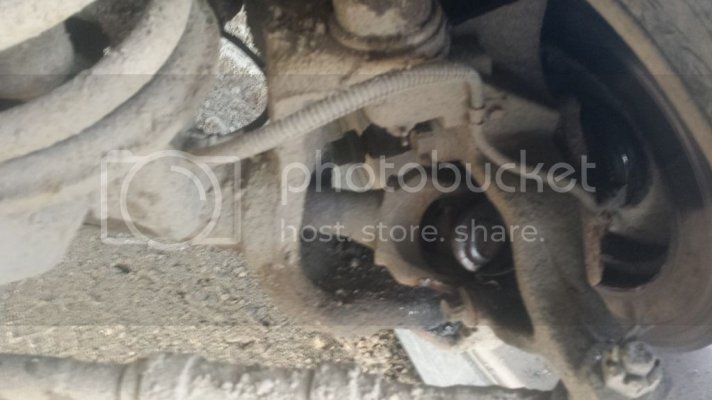

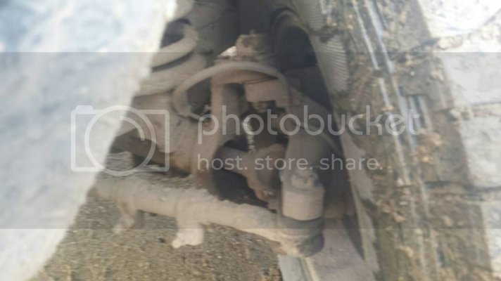

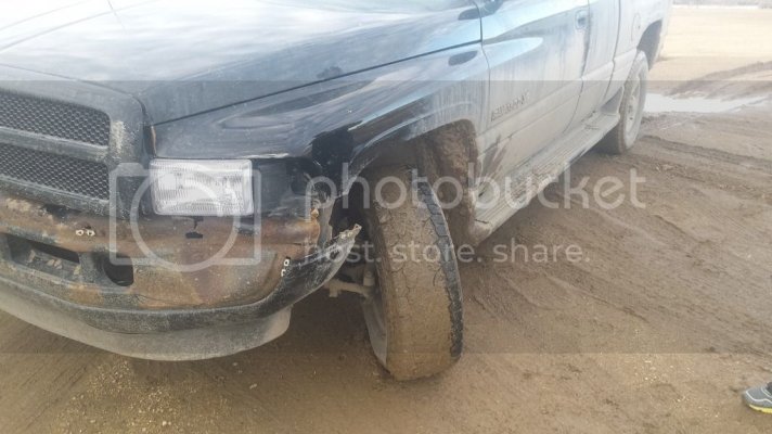

Well let my room mate borrow my truck to go to the grocery store and it comes back looking like this. U joint up there sheared off my question is did this happen because the u joint broke? Or did something else break causing the u joint to break? I've only owned fords in the past so i have no clue about anything suspension related. I'm just glad this didn't happen on the highway, i dont know if my room mate hit a curb or something and ill never know cause hell never tell me the truth if he did. The fact that this thing was in a collision on that side could just be a coincedence i suppose but i noticed walking out of the gas station that that tire had more camber but i chalked it down to the collision causing the allignment to go out of adjustment.

New unit/hub bearing (all one piece), new cross-joint and possible axle shafts. This was no ones fault just lack of maintenance and a worn out part that should have been seen long ago.

TIMKEN Part # SP550101 $194 at rock auto plus your other parts.
MOOG/PRECISION Part # 371 cross-joint $18
DANA HOLDING CORP Part # 747601X full meal deal $324 both shafts and the cross-joint

Ouch I might just go to the j yard to get an axle shaft and get the rest new is there any possibility the shaft is okay? Edit: just read you said possibly axle shaft guess I'll know more tomorrow when I dig into it

This is why only I drive my truck lol. If I have improperly maintained something I'd rather it be me that gets in the accident. That and I don't trust others driving without totaling it.

Big thing to check will be the ears where the cross-joint cap fit, if they are messed up they are toast and the axle shafts will need to be replaced. Be ready for a fight getting that unit bearing out they can be a pita, so can the axle nut. You have a 1 & 11/16ths socket and a 9/16ths 12 point? if not you need these to do this work.
Check the 2001 fsm for how to do this job.
