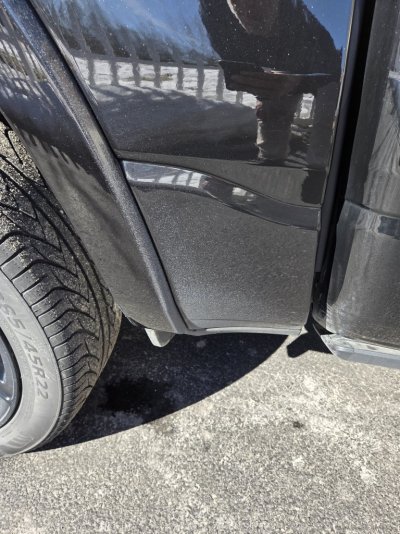

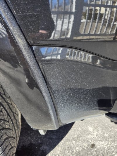

2025 Ram 1500 Laramie.. So after my first winter with this "brand new" truck, this began to happen around the rear wheel flares.. I went to the dealer immediately.. I keep my truck spotless.. wash it by hand, winter use touchless wash only(high powered sprayers)..and even put a nice coat of wax prior to winter.. The dealer ended up telling me that they've never seen it before.. sent a claim in and it was denied.. blamed it on road conditions, winter weather, etc... This past winter was 2nd winter with this truck.. the pics I'm posting are of the truck now..washed, dried... It now spread all up the flares..and now is beginning to stick to the bottom panel of the truck! This is not normal..I've never seen anything like this before.. I live near Albany, NY.. have had Rams, Fords, Lexus, Toyota... never seen anything like this. I believe it's a paint defect.. no clear coat was used, or improperly painted in production. Anyone out there, agree? disagree? Any way to salvage this? I love this truck..It was a 70,000$ truck (sticker was at least).
A friend works for Ford dealership in their Collision Center..he offered to pop the flares off and pain them for me, at cost..but why should I have to go through all that and pay for it.. Not a happy Ram owner..

Although yours looks pretty severe for one winter, that's common, especially in front of the rear wheel wells, if you drive in areas where the local road crews put down any kind of gravel or sand for traction. The only way to mitigate it is to first cover that entire area with ppf. Or park the truck for the winter lol. Or you could do what I do and winter in Florida. :anitoof:

Dealerships are sometimes helpful, sometimes not, and the specific wording used when submitting a claim can make a huge difference in the outcome. Do you have any other nearby dealerships to try?
You could try your luck by reaching out to @RamCares via PM.
Include the VIN and any details. You can't PM pictures.
They can sometimes facilitate a repair or help with obtaining warranty coverage.
My truck has almost 5 winter seasons of abuse (was new in January '22) and looks relatively clean in comparison, IIRC. It may have a barely noticeable version of that damage, not enough to capture in pics.
Ontario keeps the roads jammed with chemical crap all winter, up here.

It may not be your responsibility but I think if you want it repaired properly, I'd suggest you have the flares repainted then wrapped with PPF for added protection. I doubt that fighting with your dealership is going to result in a solution that you will be satisfied with.

My parent's Durango and GMC Colorado both have this bad, it's very common on newer vehicles. If you want a fix it will have to be aftermarket. The only weird thing is the dealer acting like they've never seen it before, could just be a lie to get you to not make an issue about it for them.

Is it actually paint damage or water etc marks on top of the paint? I would try to clay bar it and then ceramic that area for sure, and rest of vehicle.
I have no experience using clay bars.
Would it be similar to using a rubbing compound?
I have had great success removing surface marks with those.
