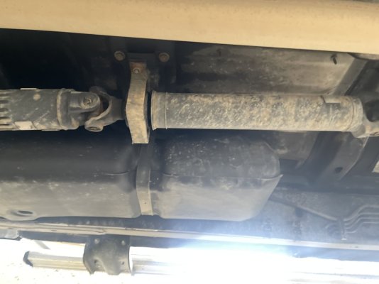

Looks like a 2 piece driveshaft by the way. See attached picture . Maybe the carrier bearing or something in this vicinity ??

Get under there and check for loose bearing housings on the ends of the joints. There should be no up and down or in and out movement on the joints. Also check the slip joint near the support bearing, that might be moving up and down, the slip joint should only be sliding in and out. Check the joint at the transmission output and the joint at the differential. Also check if there is in and out movement at the differential with a pry bar of some type or a big screw driver, but do not damage the grease seals near the bearing cups on the universal joints.
