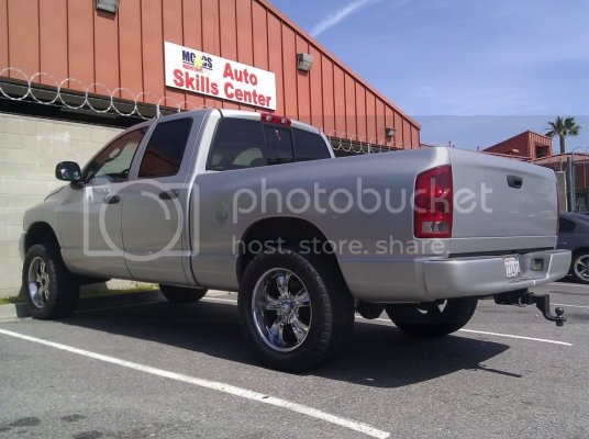

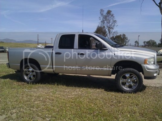

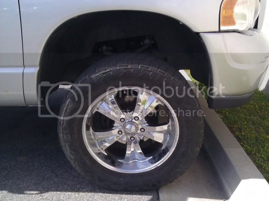

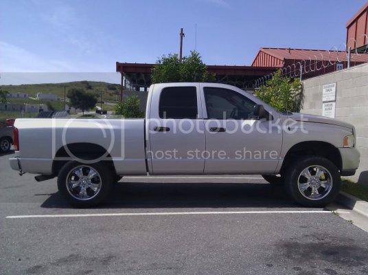

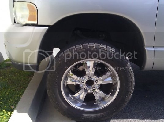

Heres some pics I have from earlier
Heres a comparison. Don't know if you can tell or not
First pic is the one that is closer
Heres how it rubs
And just for fun
