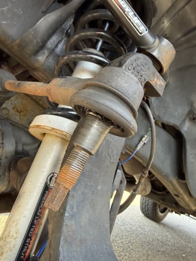

-Are the lower ball joints suppose to look like that? Could it cause a problems?
-It wont let me post another video but the first picture is the driver side wheel which is the wheel bearing i just replaced. At 9 and 3 it moves a bit but theres no noise from the wheel bearing that i can tell. The inner tie rod does move a little when i do move the wheel at the 9 and 3.
-the second image is from the passenger side wheel and at 9 and 3 it does move a little but the tie rod does have a little more play than the driver side. I do plan on replacing this wheel bearing as well soon. Could this be an inner tie rod issue?
I do plan on going over the wheel bearing I just replaced to see if anything looks out of place. Since i have a 6 inch BDS kit, are there aftermarket inner and outer tie rods designed for this lift? I will appreciate any help given.

Wow, is that front end loose. No wonder you are getting a wobble.
Up and own play is usually ball joints.
Side to side play is usually steering components
Play in any direction is usually wheel bearings.
Control arms add a 4th dynamic of play if they are bad.

yea good thing as of right now is just steering component. i might pop out the outter tie rod when replacing the wheel bearing to make more space, is there a way I can check if they need replacement as well?

Update:
Took out the wheel bearing that I just installed on the driver said. Torque everything correctly now, but still saw play in the steering area, looks like I will need to do inner and outer tie rods. I was looking at the UCA and I might need to replaced it sometime this year, I was looking at JBA and Core 4x4, which one would work for a bds 6 inch?
I did noticed the balljoints look like they need to be greased. What type of grease do ya recommend using?
