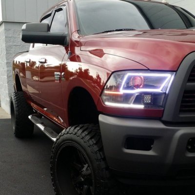

I like the stretched look only if its on an aggressive tire like a grappler or nitto mt. Similar to the pic of brandonjansen ride, or the below photo:
Ok the red truck didn't look bad. When I searched the stretched look it came up with all import cars with the wheel waaaaaay past the sidewalks of the rubber.

Ya, the import definition of stretched is far different than the red Ram you posted or my truck. Mine aren't actually stretched at all... just wide wheels.
Based on what you're looking for I'd say a 10" or 11" wide wheel with a 33x12.5 tire would be a good choice. It will give you a similar look to the red truck or mine tire wise. You could go 12" wide but they're going to look even more stretched than that plus you'll have more issues with fitment.
A 20(or 22)x10 -12 offset wheel with a 33x12.5 will stick out past the fender by approximately 2.5" total. If you have OEM flares you can take 1" off that number (as they provide 1" of coverage). You'll fit that setup on a leveling kit with no issues as well.
