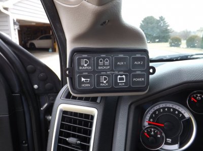

I don't know if this helps, but I anticipate 3 switches but there could also be more. I like the rocker switches with led light on them...think they are about 1.75" deep plus a little more room for wire terminations.
I think a great idea would be on the roof console to the rear of sunroof and back window controls. The factory controls lay horizontal and I was thinking about installing these new switchs "vertically"
Hopefully someone has done this????

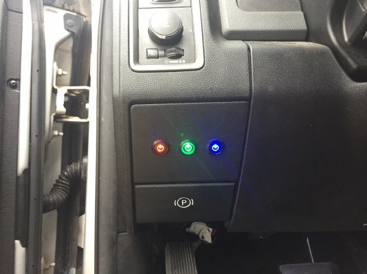

This spot works great for my '13 (6spd) because there is nothing behind it and it is a $5 panel to replace if I ever need to take the switches out.
Red switch - LED light bar on grill guard
Green switch - unused (for now)
Blue switch - rear LED pods

This spot works great for my 13 because there is nothing behind it and it is a $5 panel to replace if I ever need to take the switches out.
if you have the 8spd trans you cant out anything there, that area has the emergency park release behind it on our trucks

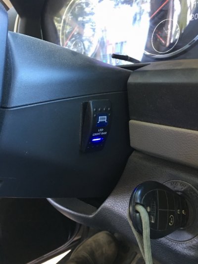

Installed mine in the side of the steering column cover.
I like where that is installed good idea for my next switch
