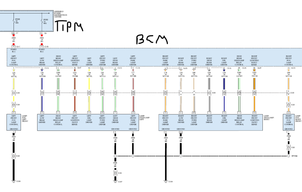

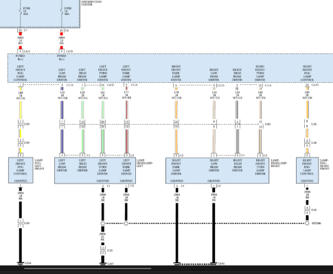

Here is the zoomed in section that shows your headlight and fog light wiring. As you can see, the power distribution center plays very little role. It's pretty much all controlled by the BCM.
Unplug the BCM and check the connectors for damage, corrosion, broken wires, etc. If it's all good, then get a multimeter and a test light and start testing those wires. Many times, when there is a bad connection at a connector, or a damaged wire is shorted to ground, the resistance in the short will change when the connection is loaded with current.
