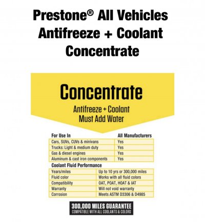

Some Mopar is an orange color and the same stuff. The thing is all this is hogwash. The only one you can’t mix with it is traditional green. You can use Prestone universal all day long with no issue. The Dexcool issue isn’t a think anymore either as far as I know they only had that issue when mixed with traditional green. I have 3 gms right now and use Prestone universal in all do them! Use it on everything when I replace the turbo actuator on my new Ram I will use it too! The color stuff is a riot. Look at the label attached can mix no problem. This is a dealer scare tactic if you ask me. Sorry I can buy Prestone universal concentrate for around $11 at Walmart. That means $5.50 a gallon for a trusted brand. The dealer crap is lowest bid anyway.

Yes Prestone universal is yellow OAT and lasts longer than the Mopar stuff.
