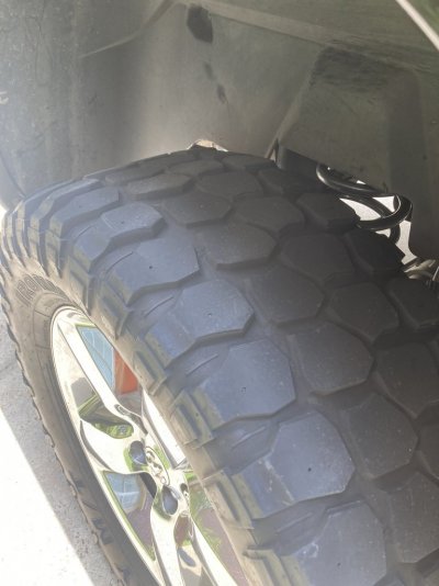

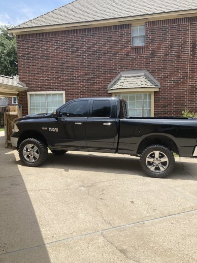

Here’s a couple of pictures. The tires were balanced when installs apparently. I haven’t done alignment yet since lift install. I have that scheduled for tomorrow, hoping that will fix some of it but the tread on these is very uneven I think by design. Some knobs are taller/shorter then others.

I’m super confused. Those tires where installed at time of the lift? How many miles ago? Those things are a gonner. They will ride like chit forever now and the cupping is so bad. You sure you don’t have other front end issues going on?

It is what your tires are. Notice the high and low spots…more commonly known as cupping.
I am equally confused as some others - if you just lifted It, but the tires were used and cupped you bought a used set that will not get better. Some guys reverse rotate them to get the cupping worn down on the opposite side but the reality is you need a new set to find out if you have other issues.

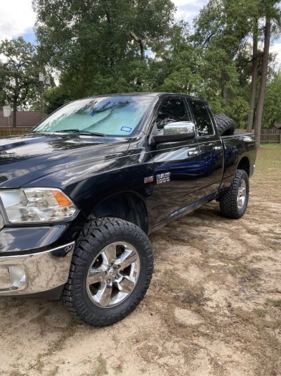

Here it is with the new tires. It rides 100% better. 80mph no vibrations
Sometimes the less expensive route is a costly one. Your new shoes look great. Don’t forget to get the alignment done….you don’t want to deal with worn-out new tires. Not cheap! :)
