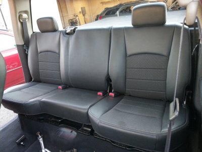

Found some great seats at a very good price on Craigslist. They are out of a 2017 Ram. Wondering if anyone knows if the will go into my 2006 without modifications?
HemiLonestar
Navy Badge Coast Guard
Jun 1, 2012
6,815
4,690
MD

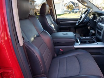

They will physically bolt in, after that you have to sort the wiring. Also the seat belt buckles are different so you'll have to transfer the old ones to the new seats. These are 09-12 seats in an 03:
