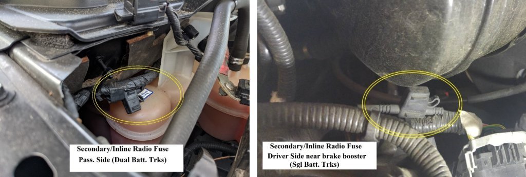

Pretty sure there are 2 fuses for the radio. One is an inline fuse along the drivers side of the firewall in engine compartment. I may be mistaken but pretty sure I recall that being discussed at some point.
Did you try doing a hard reset on the radio? Use the search function above to find the procedure.
My 15’ has that inline fuse, under the brake master cylinder, just to make sure it’s hard to get to.
