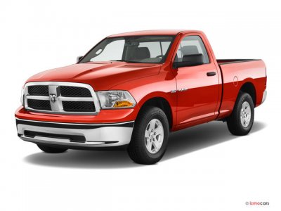

Putting bumpers aside, will a 2009-2012 grille fit in the place of a 2013+ grille?
Here’s what I’m looking to do .
I’m looking to swap a 2500/3500 bumper on to my 2016 1500. What I have found from others that have done it is the need to replace the bumper, hood, and grill with 2500/3500 parts.
What I’m wondering is since the 09-12 1500 grill is squared off on the bottom like the 2500/3500 grill is, if I can just get away with Replacing the grill with a 09-12 1500 grill and adding the 3500 bumper.
Any info would be appreciated.

i think you will find that the grill is taller on the 2500 so putting a 09-12 1500 grill with a 2500 bumper would most likely not work how you want.

No the bottom corners are different
Yes I am aware of that. Like I said I want the squared off corners.
Correct, I know the 2500 grille is taller, but on the upper part of the grille. The lower section of the grille looks to be the same from the headlights down.
