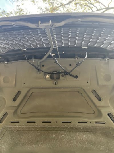

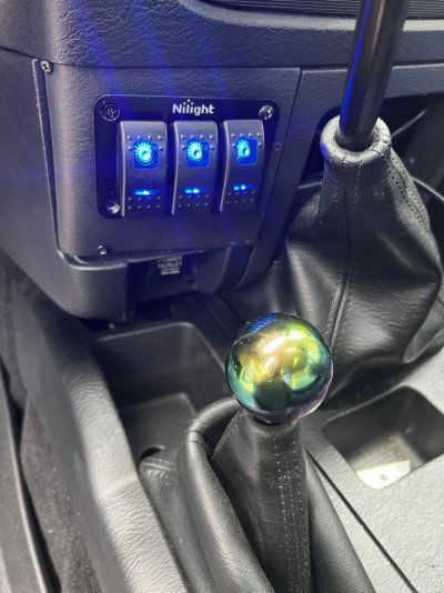

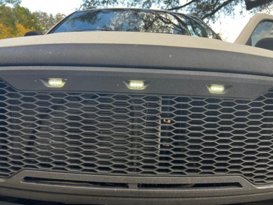

the first thing i did was change from amber to white. Then I got me a nilight rocker switch. After wiring it up I used a fuse tap that would allow the rocker switch to come on only when the key was activated. Give me a few minutes and i will give you an actual pic of my set up.
Likw Hemi said remember that when that hood goes up you need to have plenty of slack cable to go with it.

Is that a manual third gen????

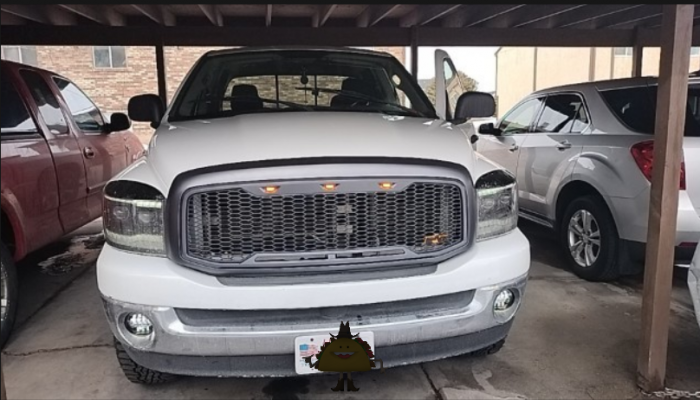

So a little update, ended up just wiring to the fog lights for now. It's not exactly what I wanted but this way I can control them. Looks pretty decent :)

That is so awesome, didn't even know they made them manual. Makes me want to go out there and look for one.
You could get a 3.7 or 4.7 with a manual, or a 2500/3500 with a 5.7 and a manual. They wouldn't put a manual behind the 5.7 in the ½ ton.
