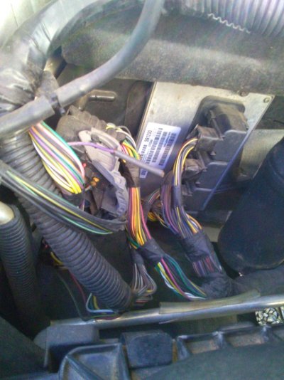

KIMG0273.JPGIf you have the 2007 DR factory service manual with wiring diagram that would help. On further investigation with the truck running, I raised the fuse box wiggled the wires. I took the steering column covers off wiggled those wires and the fuse did not blow. I have had the truck for 4 months. It does have a Dorman aftermarket fuse box. My best guess is the WCM or SKREEM is intermittently causing the fuse to blow.
I found a purple wire at the plug for the PCM that is not connected. Without a wire diagram, I don't know what this wire is for.​

Update! I stopped using the key fob that the truck shutdown when driving two times. The truck has not shutdown since I stopped using that key fob. Is it possible the key fob could cause the Skreem (Skim) to lock up and draw too much current and blow the fuse? I bought two key fobs off Ebay that work except remote start.
