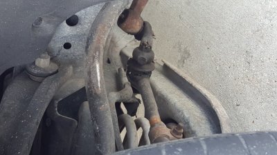

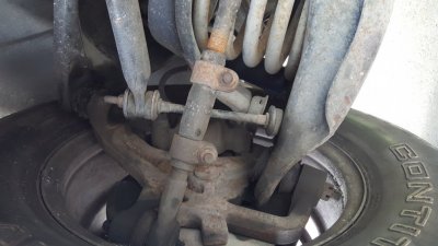

Decided to take another look at everything when I pulled up at work this morning. Everything appeared to be in place. Then I noticed this spot on whatever that's called where my tire has rubbed down to shiny metal. Then I looked at the tire and you can see the spots where the tire hits corresponding to the wobble. I took a pic of my spindle as well so yall can see what I see. If any other visuals are needed I can take pics.

I had a moment... Couldn't think of those two simple words to save my life.

I don't know wtF could be causing my tire to rub against it though. It's only that left hand slow sharp turn that when I notice it. Kinda like I'd be turning with only one lug nut holding the tire on.
