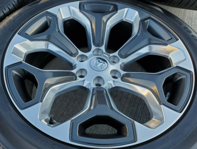

Anyone know how to remove the wheel inserts on the all new 2019 Ram 1500 limited 22 inch wheels? I would like to get them painted to match my Delmonico Pearl red color of my truck.

There are small screws on the back of the wheel that holds the inserts. They are Torx screws - 3 per insert - which you have to removed in order to remove them - and you have to remove each wheel to get them off.
I did this on my 18 before I traded it. Be careful as the paint chips easily - and I have them painted by the dealerships body shop.
