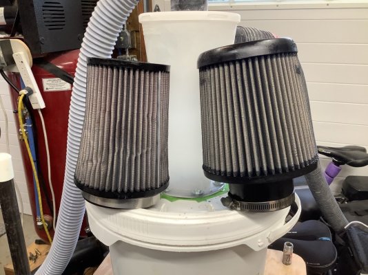

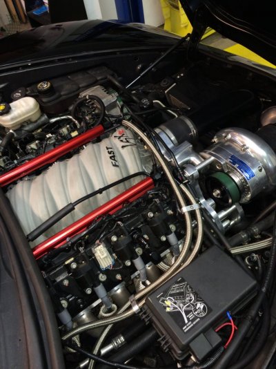

Every car and truck I have has been on my friends mustang dyno for retuning after any mod,and although I don’t claim they make any gains all by themselves,they are a first step in any performance gains and when kept clean I have no doubt they do last 100 k I have a pair for each of the 3 vehicles that use a oiled k&n so mine travel with me in case of a dirt road incident.Never said anything was wrong with the stock filter,but to say a k&n is bad is funny to me.977D564C-2873-431B-B757-B071A56CF313.jpeg316A2521-19F6-436C-8C96-5ABCFEBEB27D.jpegD5F54DDB-85F4-470D-9AC4-C21974061CEB.jpegC637BD24-B4D1-4440-938B-1F8D1AF51A88.jpeg
