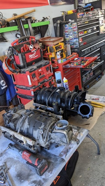

No it won't,the 6.4 intake points off to the passenger side fender Dave,so a 5.7's Vararam won't fit.If you're considering the 6.4 intake manifold swap,don't waste your money on any of the aftermarket 5.7 cold air intakes.

Why would you buy something that doesn't fit on a 6.4 intake swap,if there's other cold air intakes that will fit.Buying an intake like a Vararam for a 5.7 intake manifold,then doing the 6.4 intake swap shortly afterwards isn't really a great way to do things in my opinion,so you'll have to explain to me how that makes sense Tray. BTW i'd like to see how you'd mod a Vararam to fit a 6.4 intake manifold with-out a couple of sharp 90 degree bends. Maybe you should hunt up a pic of a 6.4 intake manifold and look at it before you comment about anything can be modified to fit,especially a Vararam

Not with one 90 you're not,and even with two 90's,it's going to take some artful tube construction to tie it all together Tray. Compare a late model 5.7's intake to a late model 6.4's intake,and you'll see what we're trying to tell you.Your old style intake doesn't resemble either intake,and i think that's buggeringg you up,as you're assuming your intake is the same as the newer active intake,and they aren't even close in comparision.

I went out there and looked up a 6.4 on the 5.7, so I'm not picturing the whole intake obviously to see how it may or may not work.

Oh yeah, I see now from those angles.
