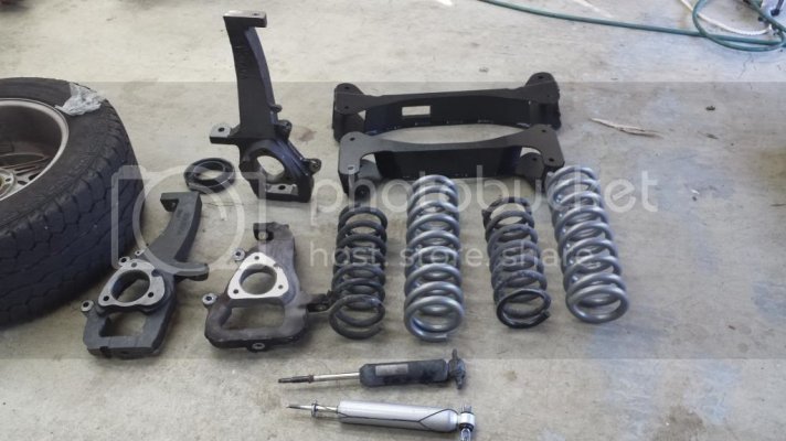

Here's another question about the RCX. When I go through what parts come with the lift, I'm not seeing the hardware kit to adjust the brake lines. Just wanting to see if it comes with one or not.
LS5DodgeRam
Feb 17, 2013
793
115
South Florida
4.7L v8
brake lines dont need to be adjusted. i have enough slack in them to not worry. a friend of mine will be offroading more than me so when he does is rcx 6 in, he is getting steel braided brake lines. i may do the same simply because my brake lines are 10 years old. and a little extra slack doesnt hurt
these are essentialy the main parts of te kit
only thing out of the picture is the rear block and u bolts, the shocks, the bummpstop relocation brakcets, the swaybar endlinks, and all the hardware to install
