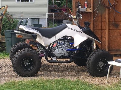

Sweet! I hear ya... I'm moving and have to rebuild my garage amongst other expenditures.It will be a while before buy a sub/box/amp, Im just doing my research on these two subs now. But i will let you know about that amp. I have spent enough money on my ram. Now its time to throw some at my quad. Gotta buy a $550 Dura blue extended rear axle, and afford $12/gallon VP 112 octane race gas for it. Haha.

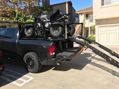

If it runs on race gas you’ll probably want an extended swing arm. This is my old quad and the rack I had built for my truck.
