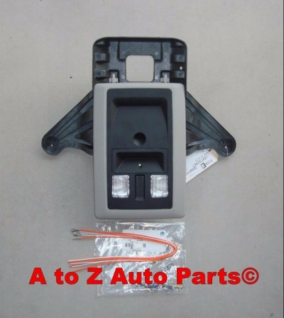

Ok, So I'd need to add all the wiring. Are the ebay kits you're talking about the ones that include just the little pigtails (like this photo)? or are there some that have an entire harness? (including wiring for lights and homelink etc.)
I ordered what you have there for mine. Those pigtails aren’t long enough to reach the green plug if I remember right? I used a hot glue gun on the wires to keep them from rattling.
Yip that's it. Remember that overhead kit doesn't have the compass module or the Homelink or anything necessary to do anything other than to install it for lights.
Ok, So I bought an overhead console from another forum member that included the homelink so if I just buy the pigtails, do they just plug into the back of that green connector (at the right locations) and then I splice in the extra wire needed to make it to the console?
And then, at the back of the console do I need to get the proper connectors? or do the pigtails plug into that as well?
BTW I like the hot glue Idea, thanks for the tip!
You might have to find the connector for the LED cup holder light but I’m not sure, mine didn’t come with it so I had to make one.
One other tip and I know you will like this one, when cutting the headliner, start small, really small and work your way out until you get what you need. I had the benefit of several work trucks that had the console so I just dropped one and made myself a template. When you get your console in you will be able to see that it’s two pieces, the black piece can be removed from the grey or brown and that will be close the size hole you will need in headliner. Be very careful towards the windshield as the cutting gets close. The front of the console rests on the lip of the headliner. Take a deep breath before you cut and then go slow, it’ll be messy this way but hopefully you make a hole that’s to big.
