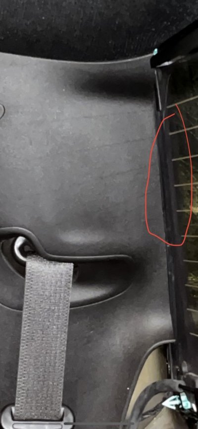

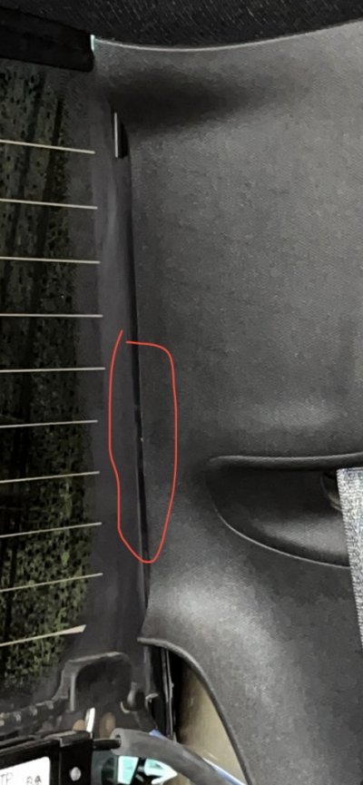

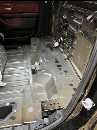

To find the source of the water intrusion I removed the rear seat, rear carpet and lowered the rear head liner. After conducting an additional leak test the third brake light, antenna and both bodyside aperture exhausters did not leak, but the rear window was leaking on both driver and passenger sides (only vertical areas - see pictures). There are no visible frame cracks. The driver side leak is worse and because the truck is parked facing downhill, the water runs along the rear and front drivers side door wire channel and pool ls in the driver foot well area. I determined that the truck had two separate leaks; the third brake light (now fixed) and both sides of the window.

To temporarily stop the leaking, I placed Flex Seal tape along the window edges. I have also not reassembled the back seat area until a permanent fix has been completed. My local auto glass shop quoted me $600 to replace with window but I’m waiting to hear what Ram Cares and the dealer has to say. It will obviously be required for the glass shop or MOPAR technicians to diagnose and fix the leak if the rear seat area is disassembled, but should I reassemble it prior to going in to the dealer? Not sure if I should be concerned that they could use the disassembly as an excuse to potentially deny repairing the leak. Suggestions on how to approach Ram Cares and the Dealer are very much appreciated.
