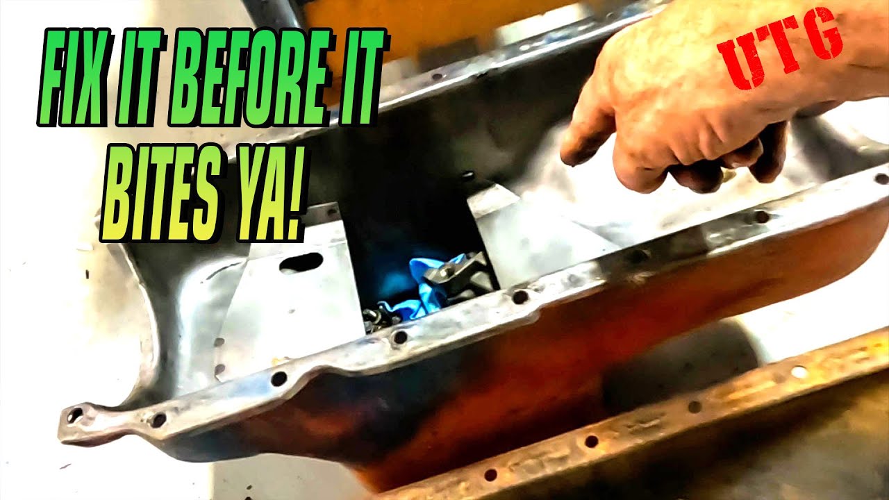

It's not gonna be variable enough to affect anything,counting what's in the pan /cooler and accusump you'll probably have 9+ quarts or more in the system,a 1/4 quart isn't really going to change things much.If you're that worried about it,buy yourself another oil pan,and cut it up and weld it's bottem end to your pan to add more volumn to your stock pan,and lengthen the pick-up tube.You can easily get another couple quarts into the oil pan,by dropping the bottom of it by cutting up another pan,or by adding a strip of the same gauge steel as the pan to the sump drop. You're way over thinking this,lol.
Here i found a video by Uncle Tony explaining how to deepen your stock pan,as i don't think there's an aftermarket deep pan available for the trucks,but you could check,if anybody might have a deep pan,it's probably Milodon.

Looks like Milodon does have a couple deep rear sump pans,that look like they'll fit the truck chassis .They also have the corresponding pick-up tube
