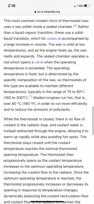

Wax composite, I see it states that all control is to the composition, so if we looked at two stats for the same engine, and one stat is a 160F and the other is 180F they would have the exact same spring but the wax motor would be different? I might have to go look because that seems more difficult to me (but I don't really know) especially by all the low end stat manu's.
