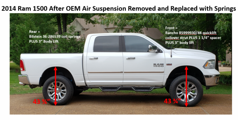

I finally did it! After repeated failures with my OEM air suspension, I had enough and removed it and replaced it with coilovers in front and coil springs in the rear.
The entire job took only 5 hours and I am very happy with the results. No more sagging, intermittent let down etc.. She stands tall and firm and I wish I would have done this months ago
My parts list is:
Rear coil spring - Bilstein 36-286539 (comes as a pair)
Rear coil spring isolator - MOPAR 2855789AB (2)
Front coilover struts - Rancho RS999930 & RS999944 (one PN is left, the other is right)
I also added a front 1 1/4" spacer to level the truck (already had the spacer)
