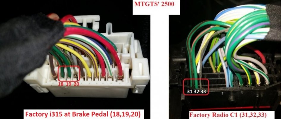

If you have the 3rd brake light (chmsl)/cargo Cam,... Then the 3 wires they saw at the back of the radio may have been for that. For 2016 with latest sw update...
> Pins 24,25,26 should be Cargo Cam
> Pins 31,32,33 should be BuCam (from connector near brake pedal at i315/i311)
There's 4 connectors in the truck your need to check for the existing wiring to see what's actually missing....

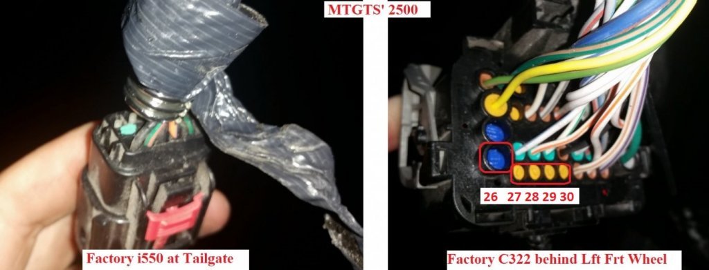

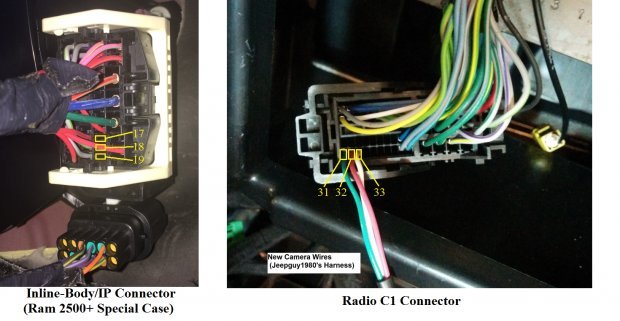

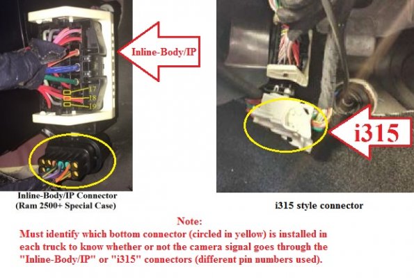

i550 tailgate connector by the spare tire should have 2 lock wires and 6 camera wires... There may be an 18" wearout extension between it and the main chassis harness. Follow it forward to check the other end for 8 vs 2 wires.
The next spot is the larger c322 behind the front left wheel liner going up the firewall from the i550 chassis harness along the frame rail. This one's trickier. You have to check both sides of it at pins 26-30 and at pin 3 for the wires.
