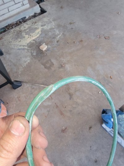

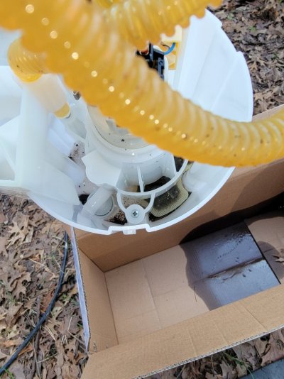

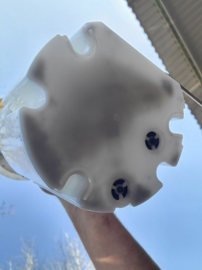

Ok update , no rain today here in sa Texas, so I went ahead and installed new pump. I think someone had replaced it before me ,the lock ring was not seated properly and green o ring was busted ,so bad install ,I removed pump and noticed debris on bottom, new pump has a grader like screen wich allows all that garbage to flow back out I think , so Installed evrything , primed it 2 times fired right up! Although it did surge for a few minutes I turned it off picked up tools , then turned it back on and it's steady idle ,drives great ,sunday I'll drive it more and report back,let me post pics of old pump...20230121_143811.jpg

All that dark is trash ,from previous installer not seating ring properly, what happend looks like the ring had bent endjes and was catching on plastic fuel pump lip ,all I did was grind it smooth and couple of whacks and it seated perfect20230121_143805.jpg

Getting all the crap out of the tank will help a lot with the longevity of the new pump. Glad the truck is running good for you, always nice when a plan comes together.
