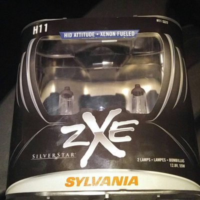

Very easy you use a panel puller and pop up the I believe it's six plastic rivets on the plastic shroud over the radiator then there will be 4 ten mm bolts holding on the grill after removing the grill there is two ten mm bolts 1 on the top and 1 on the bottom of the light that you remove as well as in the fender well there is a hatch you must pop the plastic rivet on and reach inside and push the plastic tab up to release the back of the headlights then gently pry them out the low beams h11 are located in the center of the lights behind the dust cap just swapped mine over to sylvania zxe for lows and highs the other day hope this helps
