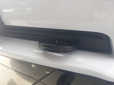

I purchased a set of used OEM tow hooks from a member here on the forum , I found a tow hook DIY here but I did a couple things different to keep the hooks from hitting my bumper and to open the gap a bit more to make it easier to install a strap .
My truck : 2014 4x4 QC EXPRESS with painted bumpers.
This is how I did it .
First I painted the exposed area of the hooks with VHT Roll bar and Chassis paint.
Next I removed the black plastic bumper insert for measuring and for cutting the holes for the hooks to protrude through.
I started with a much smaller hole , took a couple attempts to get it right .
REMOVAL IS NOT REQUIRED IF YOU CHOOSE TO USE MY MEASUREMENTS.
ADVICE ON CUTTING , if you use a heat gun to warm it up it cuts really , really easy with a sharp xacto knife . Be careful don't heat too much , start off on low for about 10 seconds max .
Both sides cut the same ! Easy to cut while installed , I actually finished cutting mine while installed .
I wanted to install the hooks with the opening outward , but due to the design of the hooks and how they install from the inside and things being in the way when I installed them with the hooks opening outward they wer contacting pretty good on the bumper without the insert installed .
So I installed the opening inward , I believe this is how they are supposed to be mounted because the way the bumper is shaped .

Even inward the hook was aprox .030" from the bumper so I modified the brackets a little to lift the hooks up to have it up off the bumper aprox 5/16ths of an inch .
Bracket modified.
I cut the right side above and on the left of the hole , opened the bottom of both holes a bit , to allow the bracket to be raised in its mounting location , and I knock out the alignment pin .
Hook mounted with modified bracket .
I then painted them while installed
Hooks installed .
Touched up paint after install because I scratched thisone during install.
Sorry so log , I hope this helps someone !

Nice write up! I did exactly the same thing. Had to turn them around just like you did.

For what it's worth they make bezels to put around the hooks to cover an ugly cut out if needed , they also make a replacement black insert for hooks installed , I've never seen either so not sure of the quality .
I opted to just trim my insert , once I figured out how easy it was to cut once heated .

Looks good. For the record they can be mounted with the openings outboard (you have to take out more of the black bezel). You can also clean up the look by adding cheap black auto door trim from any auto parts store. I did a write-up on the other forum but here are some pics. The tow hooks are not touching the painted surface, there is the tiniest bit of bezel protruding that keeps them from resting on the fascia.

Faced outwards is practical when you hook up a cable to each one for a snatch block, the tension pulls to the inside of the hook. If they are facing inwards, the loops won't stay in the hooks. Unless you're planning on taking it into some deep mud I doubt you will need to worry about hooking up a cable or rope.

I agree , but I couldn't get them to install without contacting the bumper .
The hooks are still use able for pulling people out with a strap ...
